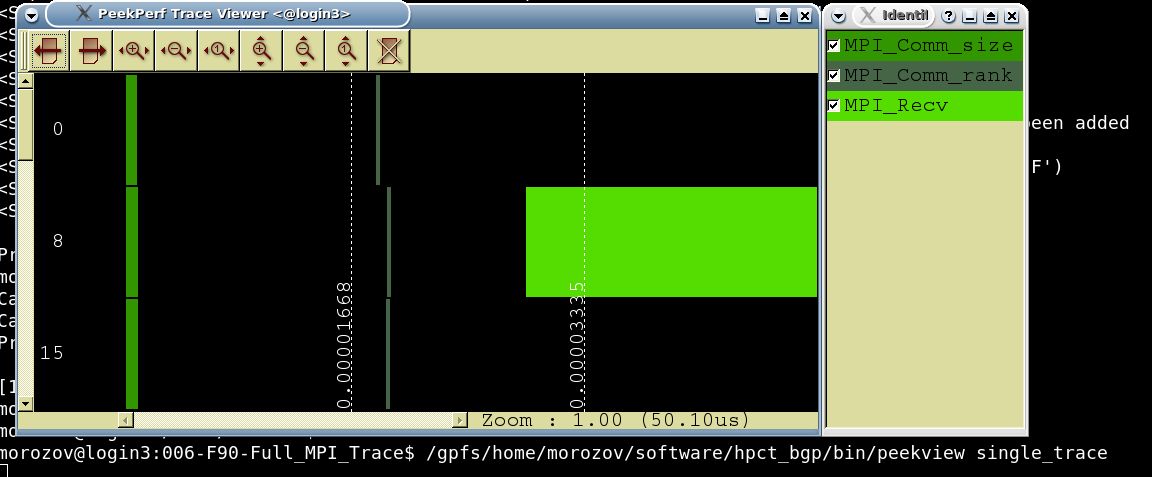

6) peekview single_trace gives the node 0, 8, and 15. Example program
was sent to the list already and contains 2 Sends and 2 Recvs. Where are
the other communications? See attached screenshot.
